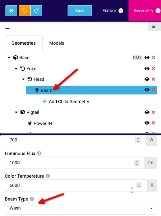

parkb096 Posted October 12, 2025 Posted October 12, 2025 Good evening everyone, I'm in the process of creating a wash fixture profile for an Artfox beam wash 19e. I've gotten most everything to work except for strobe and macros but what I'm more concerned about is getting the fixture to work as a wash rather than a spot fixture. Any tips would be greatly appricated. Thanks, Brandon
Petr Vanek - Robe Posted October 13, 2025 Posted October 13, 2025 Hello @parkb096, to set the fixture to work as a wash, set the Beam Geometry → Beam Type to Wash:

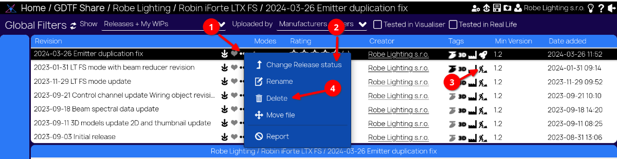

Petr Vanek - Robe Posted October 16, 2025 Posted October 16, 2025 Hello, sure, use the three dots menu (1), either change status (2) to work in progress to make the file private and hidden (3) or you can delete it (4):
