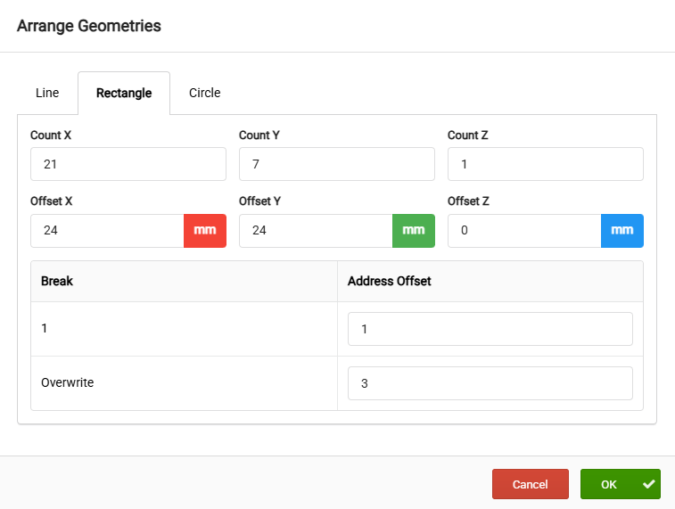

Hi everyone
basically, when I try to duplicate and arrange a geometry reference that has Break 2 and a DMX channel set to Overwrite Break, the break value is not retained in the generated copies. I expect that if I have Break 2 on the original geometry reference, this value will also be retained in the duplications. However, once the duplication is completed, the Break field in geometry remains blank and must be filled in manually, which can be extremely slow on dozens of pixels.

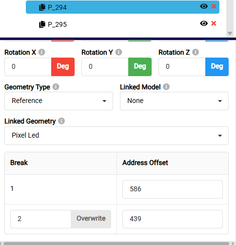

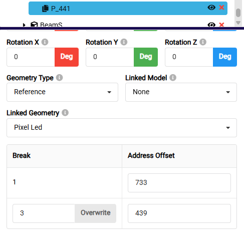

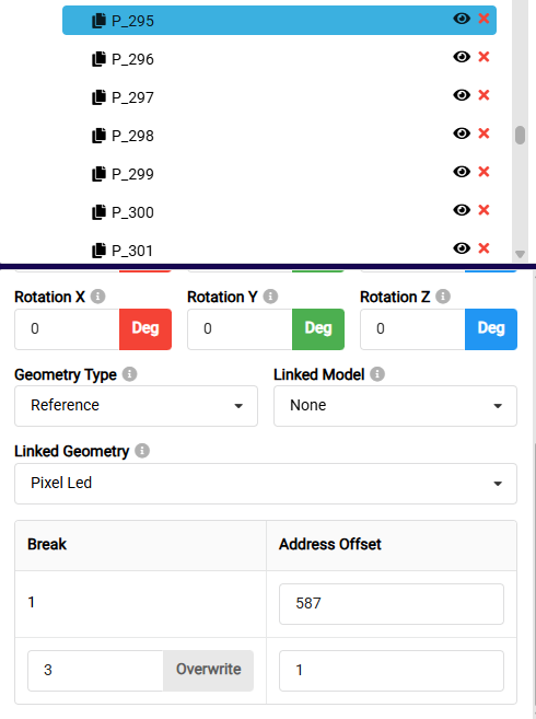

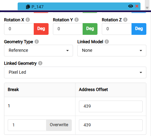

Hi Everyone,
An update and more info on the issue. For now, the best solution was to edit the file in grandMA3 and get started right away.
Another note regarding gdtf-share is that once you reload a file with 441 channels on Break1, 441 channels on Break2, and 441 channels on Break3 using Break Overwrite, the total channel count displayed by the share is 2934 channels instead of 1323 because it counts like this:
Break1: 1 to 735 (RGB Instances from 1 to 147):
Break2: 440 to 1026 (RGB Instances from 148 to 294):
Break3: 587 to 1173 (RGB Instances from 295 to 441):
In practice, the channels of the overwritten Breaks are also counted. It's just a display problem in the share because in reality there's no problem with the patch.
