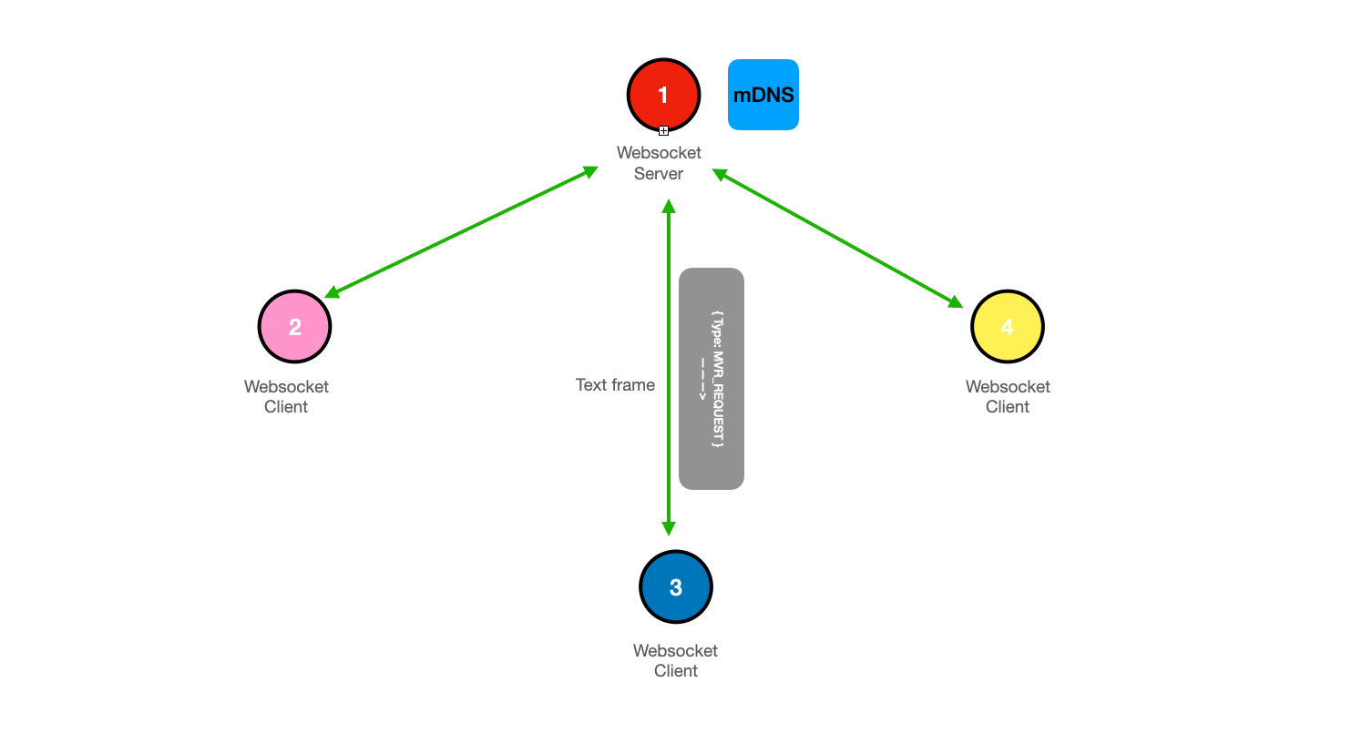

WebSocket Mode
When in WebSocket Mode, all messages should be send as data frame Text RFC6455 5.6 Text 0x1 unless otherwise defined.

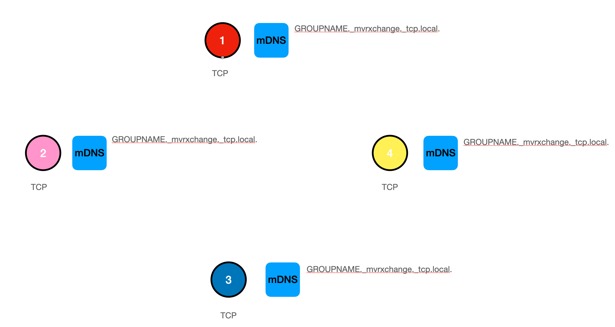

TCP Mode
Figure 3 shows the TCP mode for a MVR-xchange client joining MVR-xchange group.
Figure 3 — TCP mode: MVR-xchange client joining MVR-xchange group
a) MVR-xchange client 2 joins the MVR-xchange Group
b) and sends to all mDNS Service a `MVR_JOIN` message

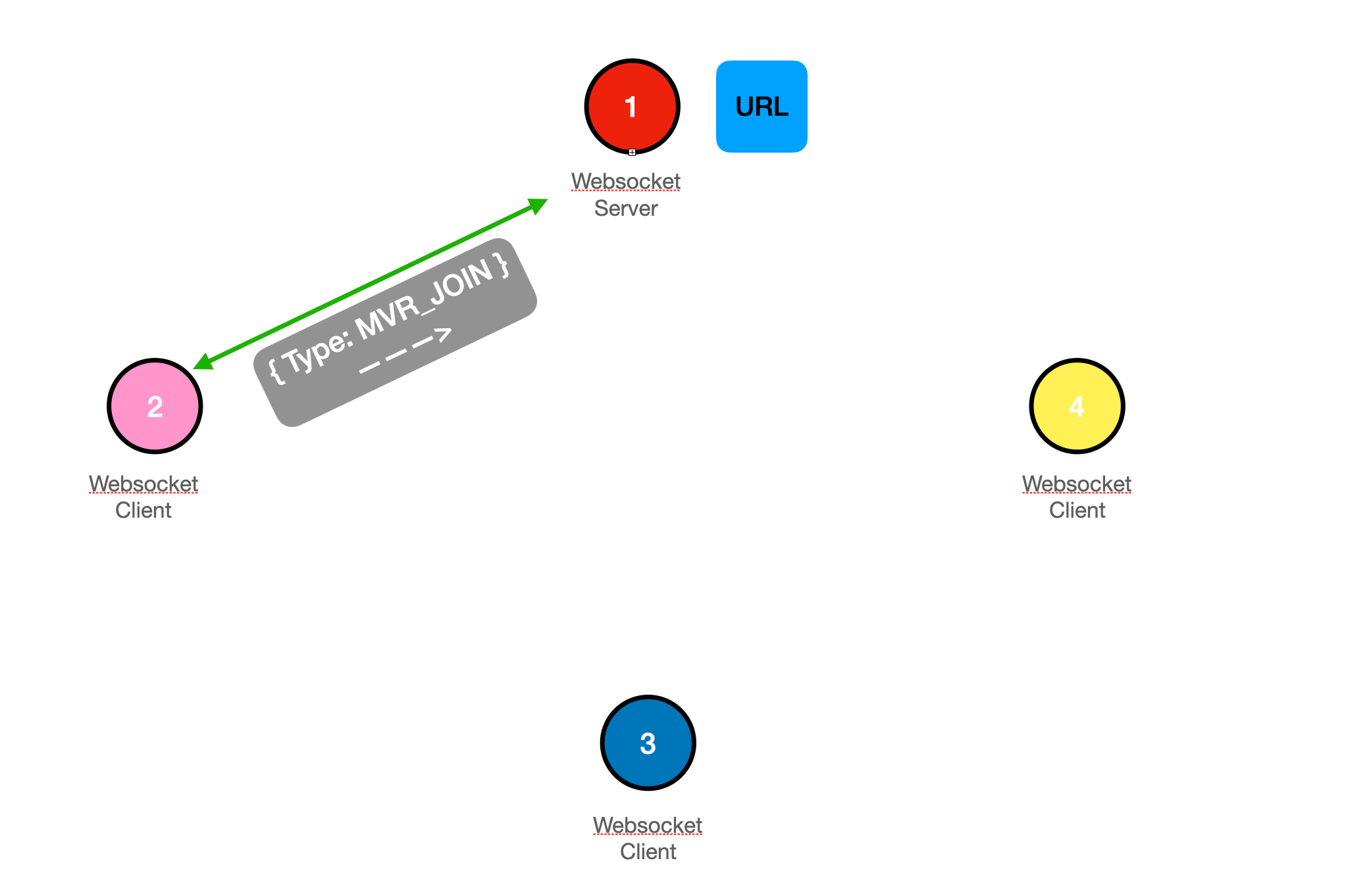

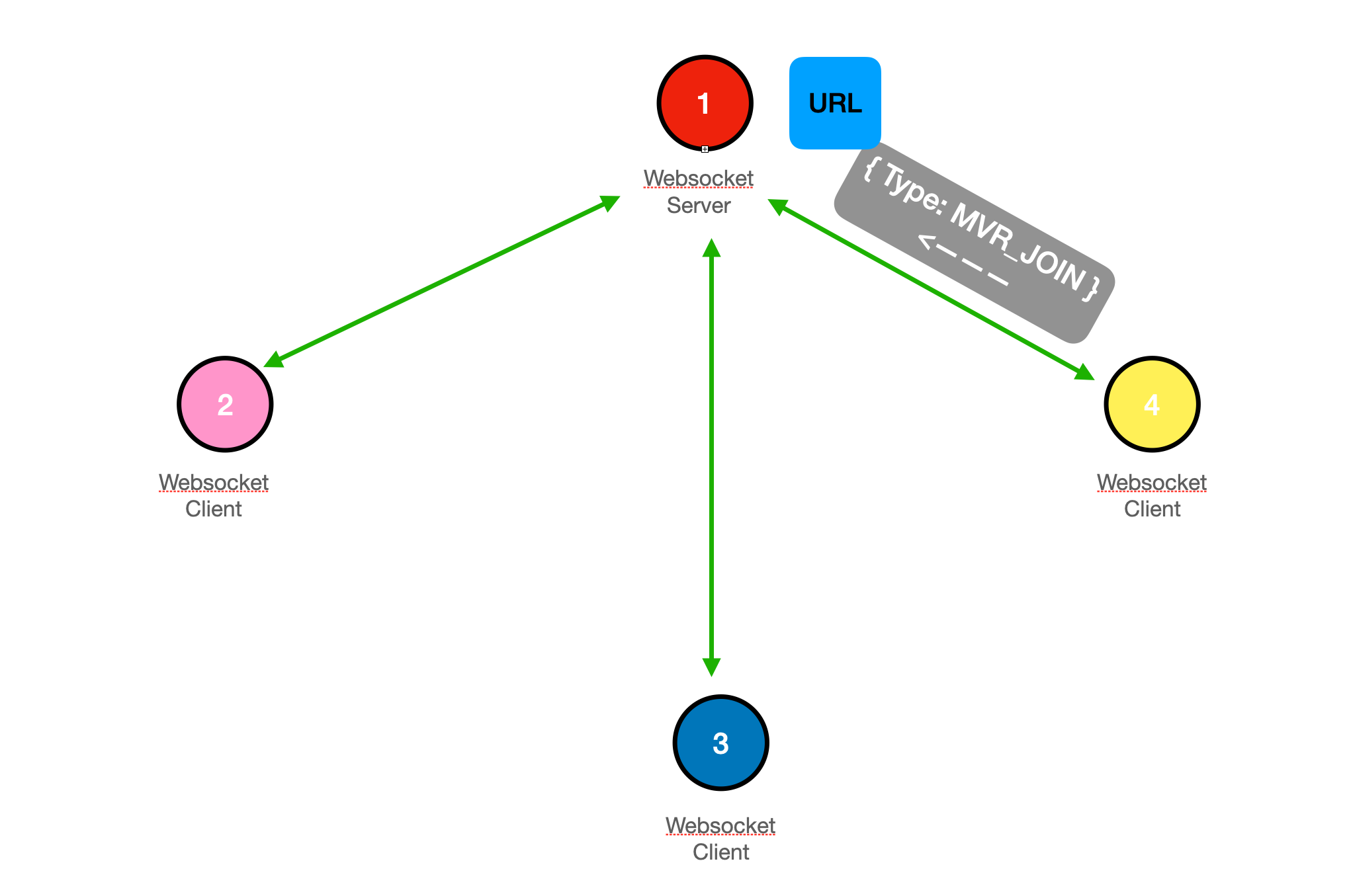

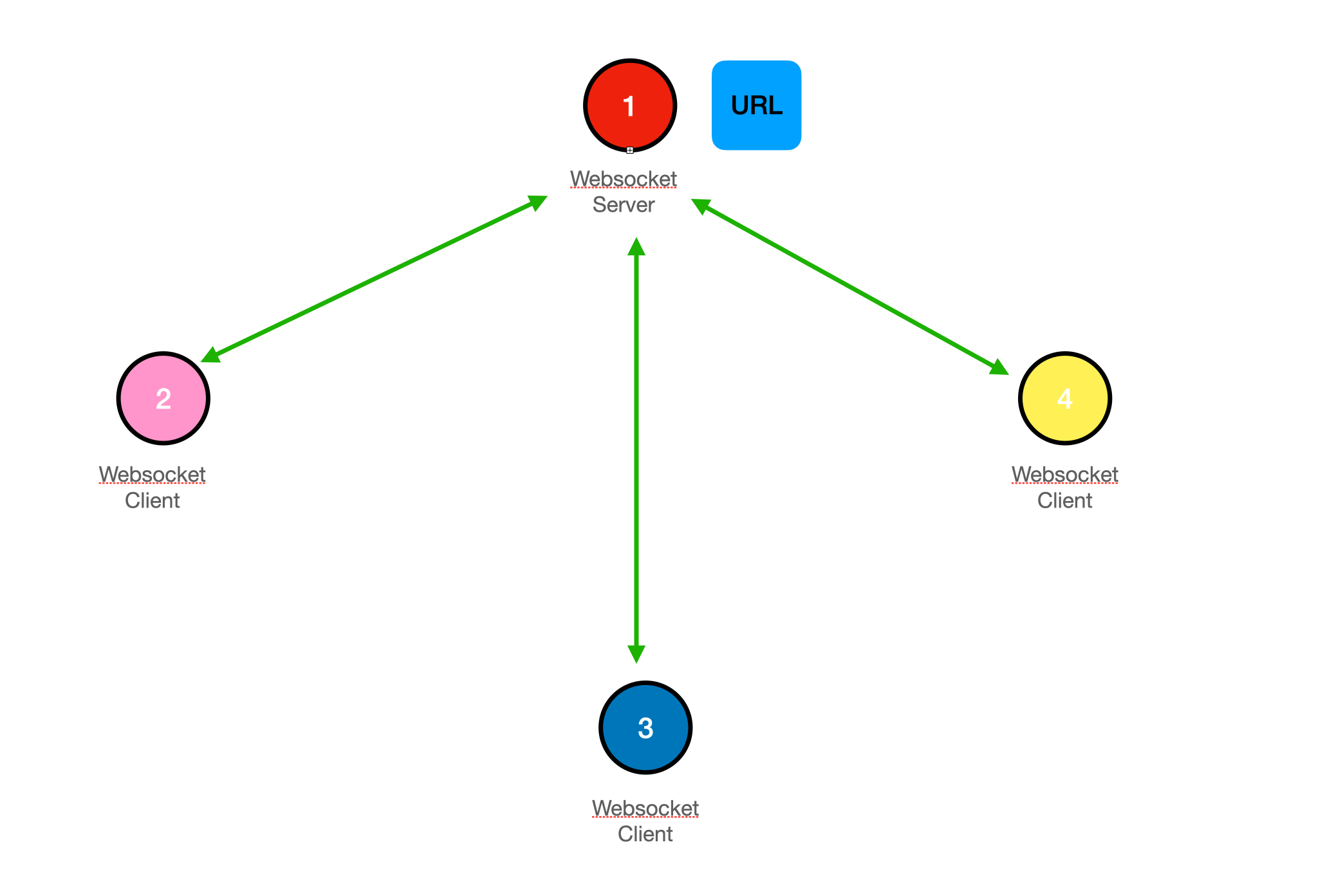

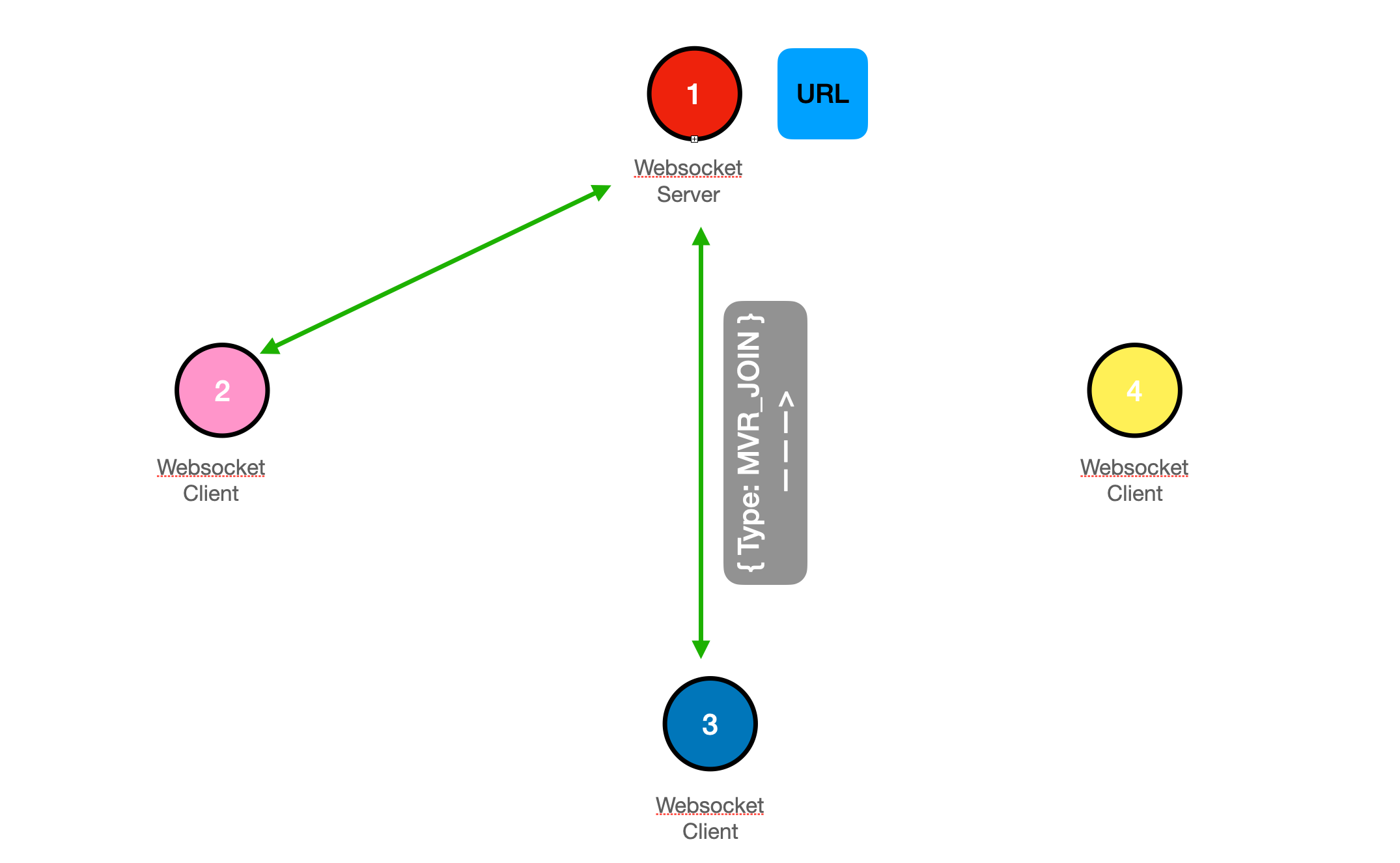

WebSocket Mode
Figure 4 shows the Websocket mode for a MVR-xchange client joining MVR-xchange group.
Figure 4 — Websocket mode: MVR-xchange client joining MVR-xchange group
a) 1 Is a Websocket Server and has a URL
b) MVR-xchange client 2 connects to the websocket server and send a `MVR_JOIN` message
c) MVR-xchange client 3 connects to the websocket server and send a `MVR_JOIN` message
d) MVR-xchange client 3 connects to the websocket server and send a `MVR_JOIN` message
The defined MVR_JOIN message Attributes are specified in Table 68.

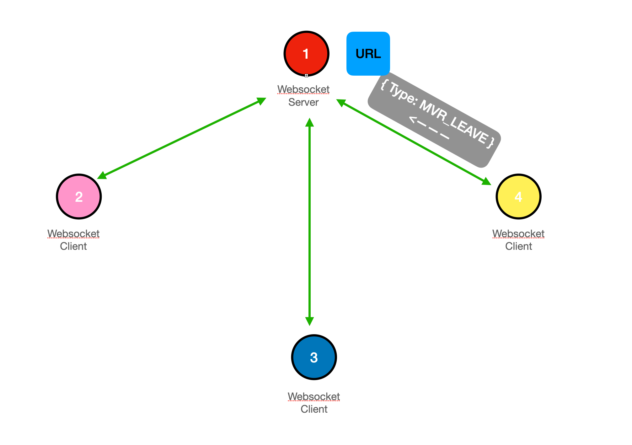

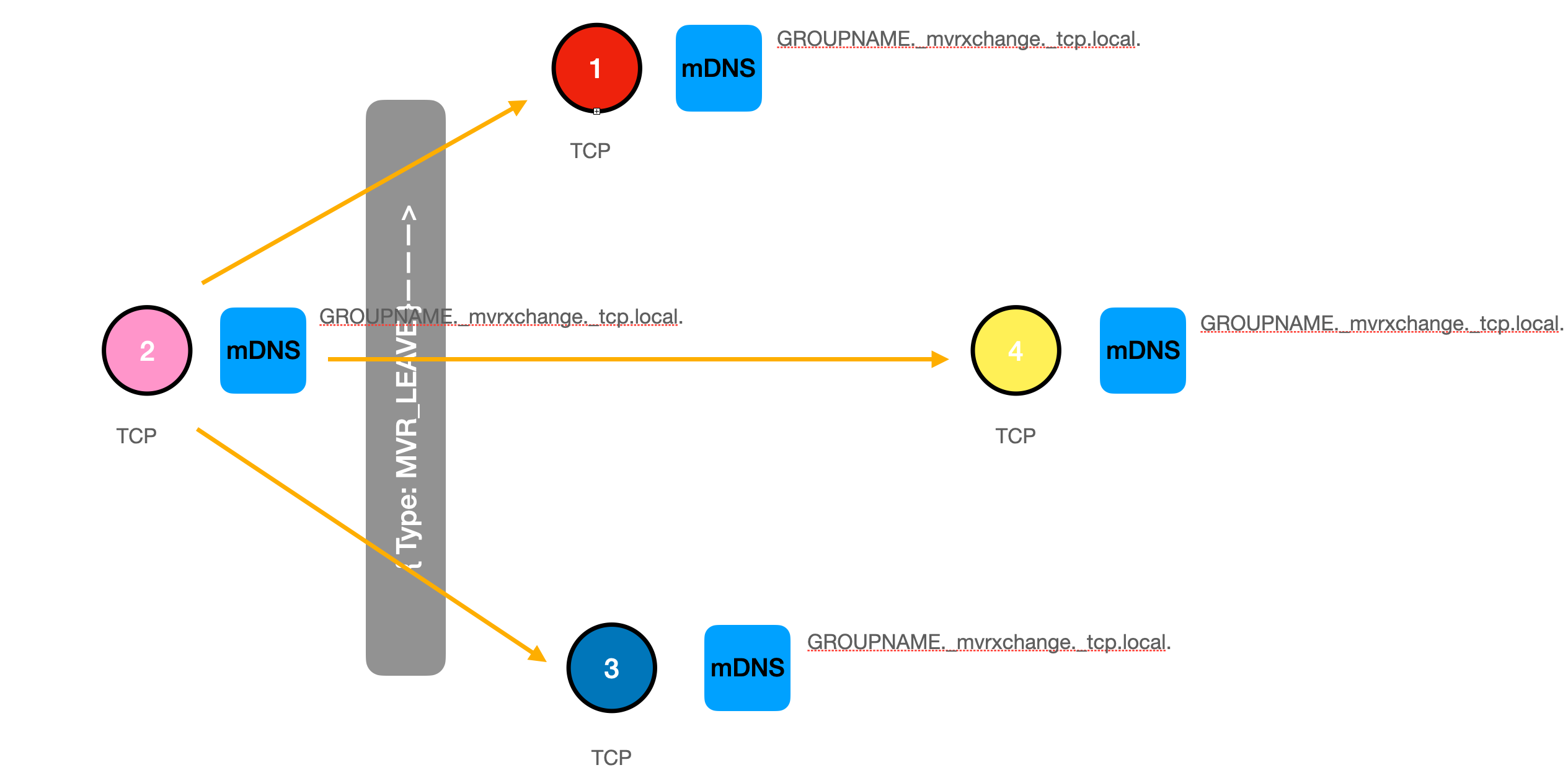

MVR_LEAVE message
A client sends a MVR_LEAVE when it wants to quit an MVR-xchange Group and does not want to get updates about new MVR files anymore.
For the WebSocket mode Figure 5 a): it is not required to terminate the Websockets connection, but it can be done. For the TCP mode Figure 5 b): it is not required to turn down the mDNS service, but it can be done.
In order to join again, the client needs to send a MVR_JOIN message again.
Figure 5 — MVR_LEAVE message to quit MVR-xchange group
a) In Webssocket mode: MVR-xchange client 4 send a `MVR_LEAVE` message to the websocket server.
b) In TCP Mode: MVR-xchange client 2 send a `MVR_LEAVE` message to all stations
The defined MVR_LEAVE message Attributes are specified in Table 70.

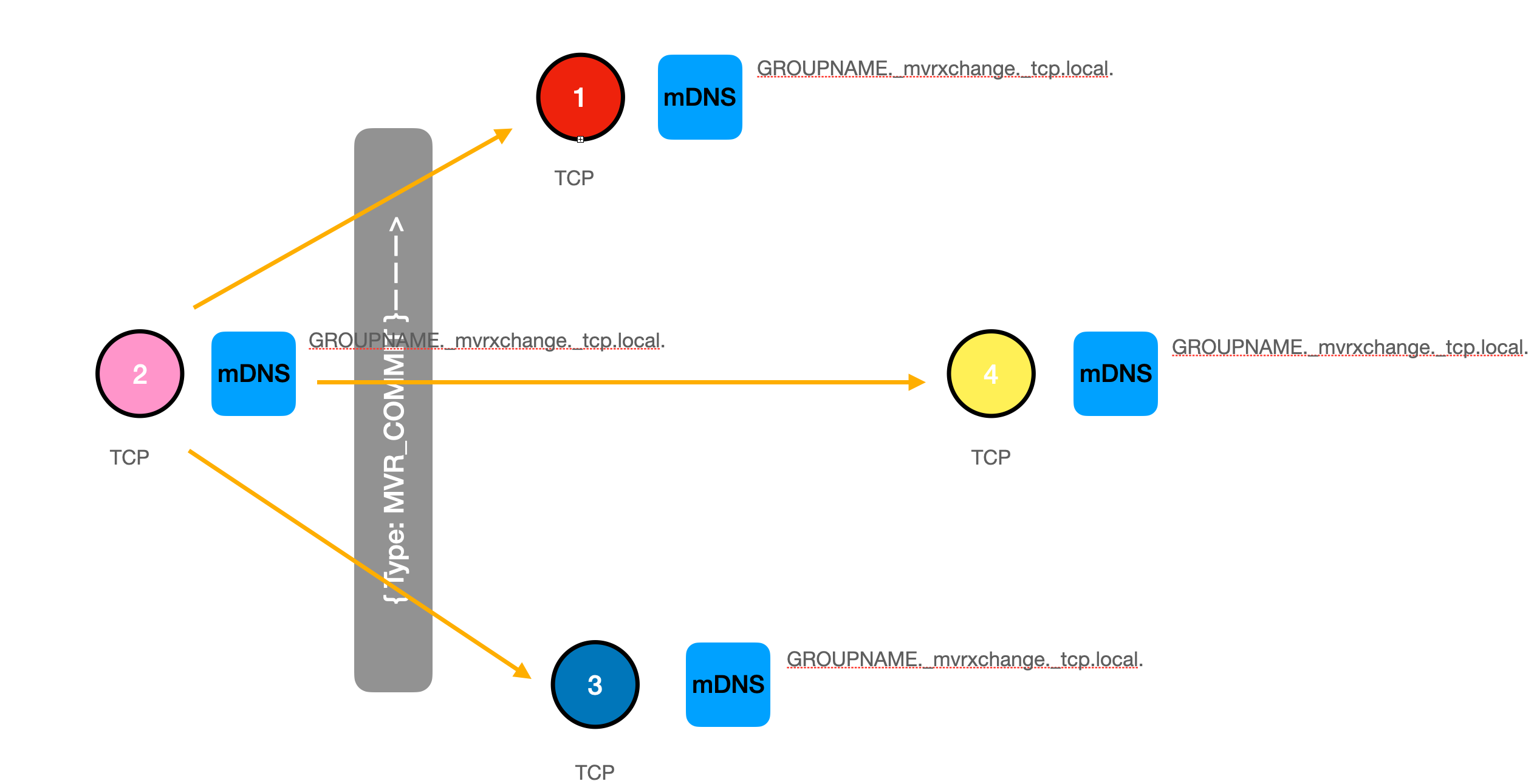

The following chart displays the process when one client sends a MVR_COMMIT message to the server, and the server distributes this in the session.
TCP Mode
The MVR-xchange client informs all other MVR-xchange clients about the new commit (see Figure 6). Note that the client needs to respect any previous MVR_LEAVE messages themselves.
Figure 6 — TCP mode: MVR-xchange client commits to MVR-xchange group.
MVR-xchange client sends the `MVR_COMMIT` message to the connected stations.

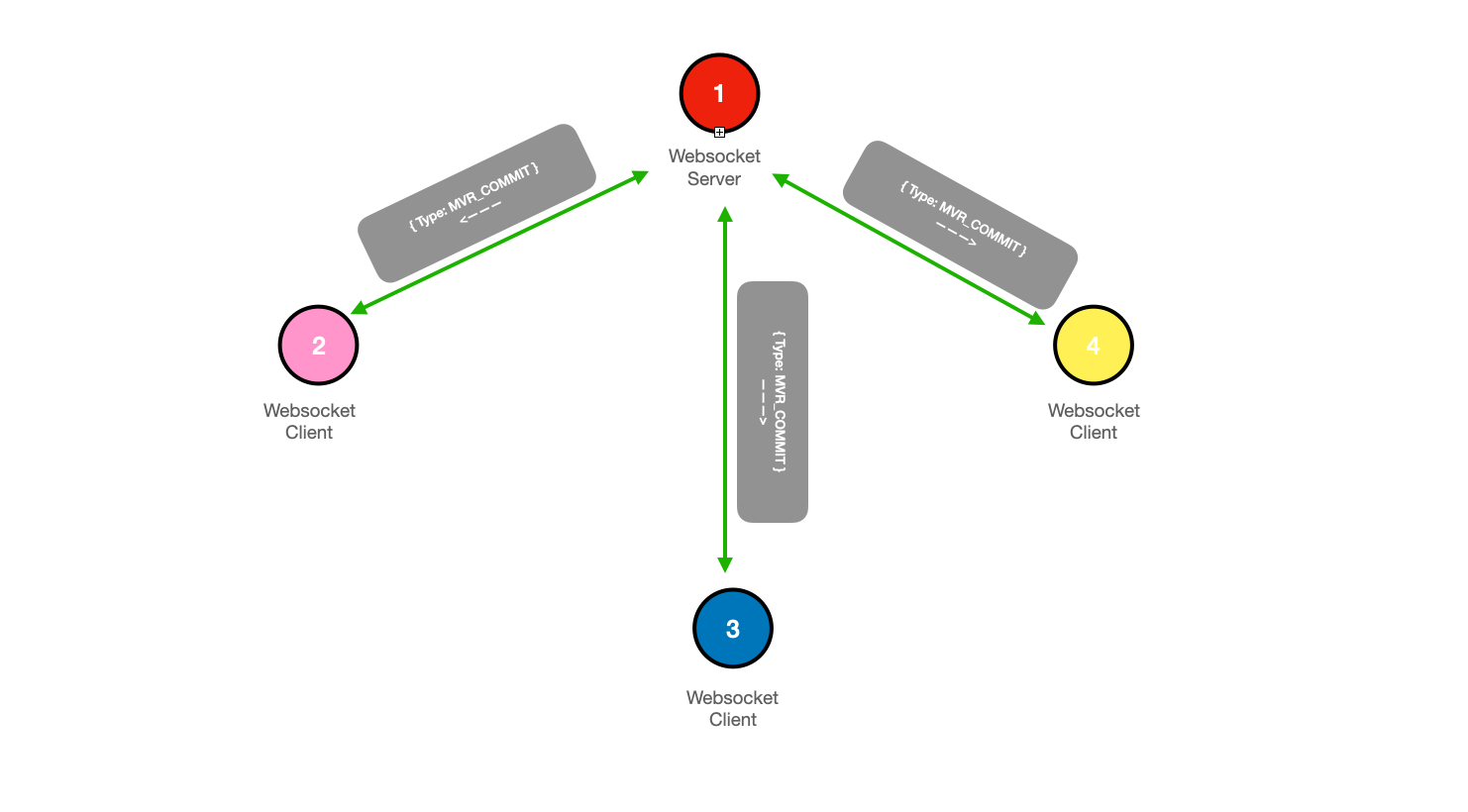

WebSocket Mode
Figure 7 shows the WebSocket mode for a MVR-xchange client that commits to MVR-xchange group.
Figure 7 — Websocket mode: MVR-xchange client commits to MVR-xchange group.
a) MVR-xchange client sends message to server
b) Server sends messages to all connected MVR-xchange clients but the sender

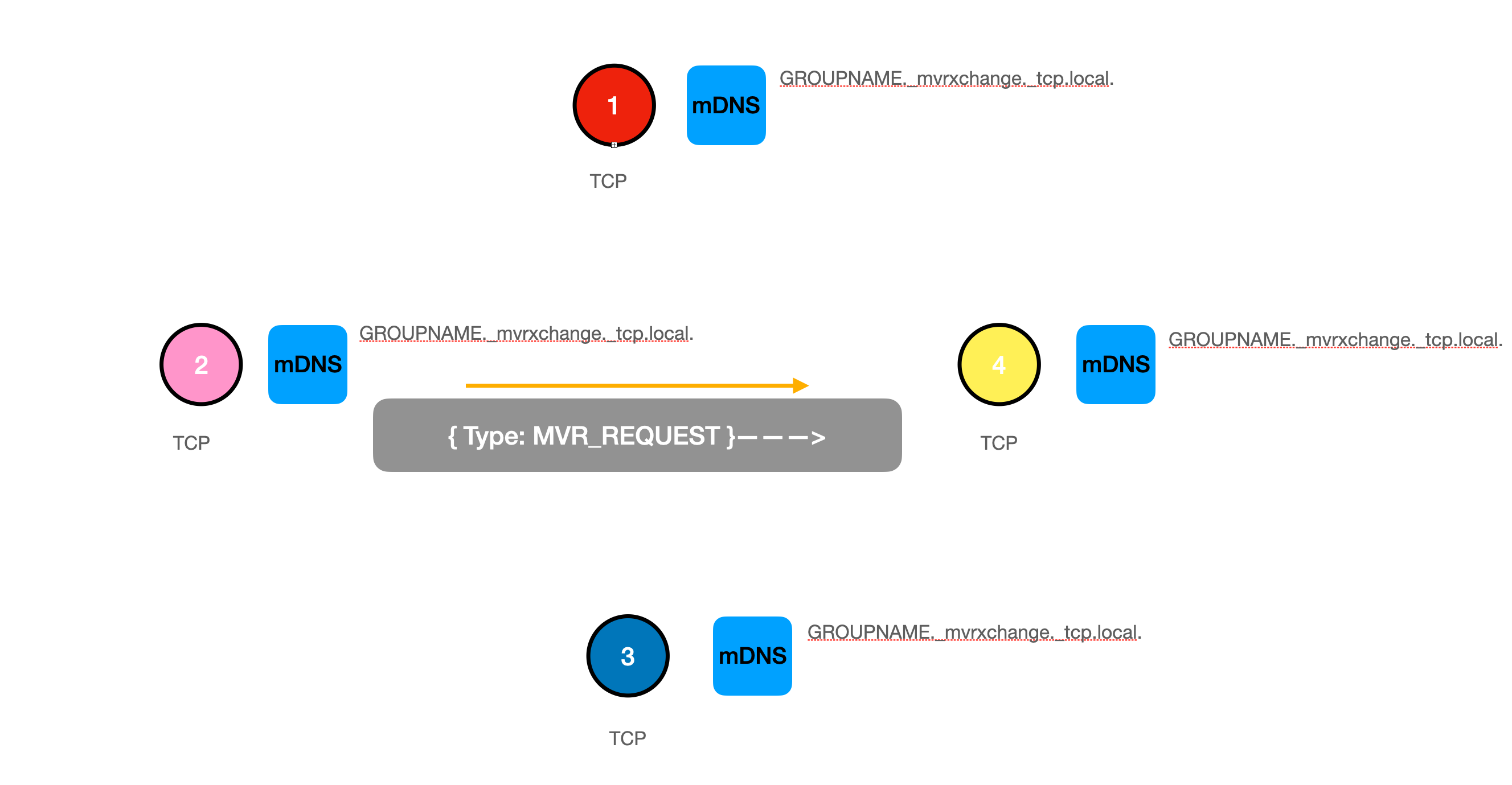

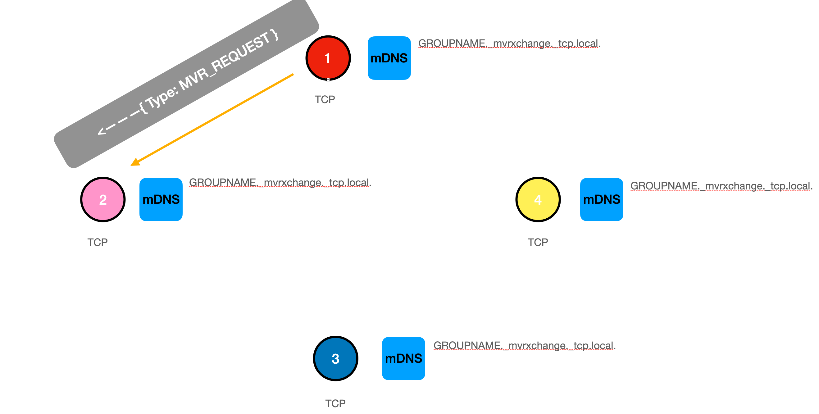

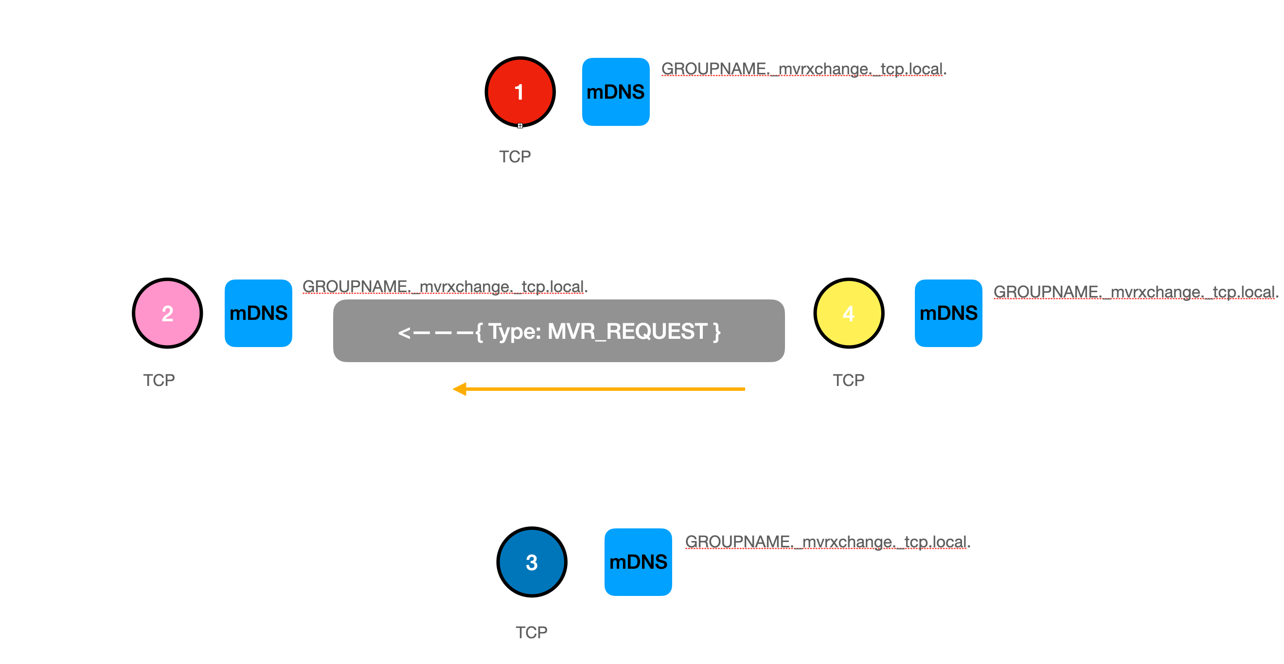

MVR_REQUEST message
This packet requests a MVR file from a station. You either can request a specific MVR via its UUID or get the last available MVR File by leaving the field empty. The underlying software will then generate a file based on the current state. This also triggers a MVR_COMMIT message to other connected stations.
The available MVR UUIDs can be retrieved using the MVR_COMMIT message.
If the station does not have the specified MVR file, it returns a MVR_REQUEST Json Response, otherwise it sends the buffer of the MVR file.

Figure 10 shows the TCP mode for a MVR-xchange client that is requesting a file.
Figure 10 — TCP mode: MVR-xchange client requesting file
a) MVR-xchange client requests a MVR from another station
b) First requested station does not have the MVR and sends back a failure message,
c) MVR-xchange client requests a MVR from another station
d) Second requested station does have the MVR and sends back the MVR file
