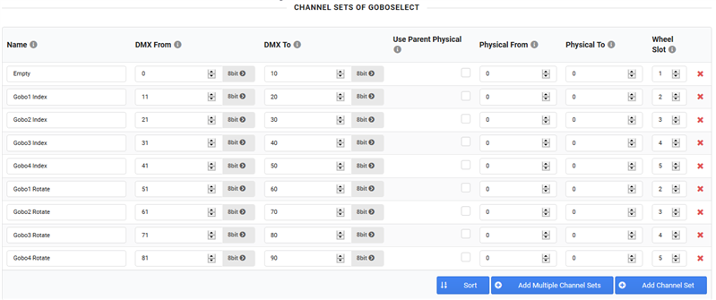

There are two value ranges that describe the selection of the individual gobos in indexed or continuous rotation mode. For every gobo there is a channel set for index and continuous rotation mode.
Channel sets Channel sets
Channel sets

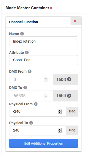

The second DMX channel has two channel functions. The first channel function (Attribute Gobo1Pos) describes the indexed mode of the rotating gobos.
Mode master container 1 Mode master container 1

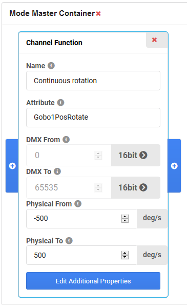

The second channel function (Attribute Gobo1PosRotate) describes the continuous rotation mode of the rotating gobos.
Mode master container 2 Mode master container 2
Both channel functions cover the complete DMX value range of the DMX channel. This is why every channel function needs its own Mode Master Container.
Every mode master container covers the complete DMX value range of the DMX channel. A mode master can contain one or several channel functions.

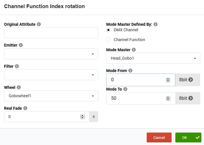

The functionality of these different ranges of the two DMX channels is linked by mode dependencies. If an indexed gobo is selected on the first DMX channel, the second channel controls the index rotation. If a continuous rotating gobo is selected on the first channel, the second channel controls the direction and the speed of the rotating gobo. The DMX value range of the selection of an indexed gobo on channel 1 goes from DMX 0 to DMX 50; The value range of the selection of rotating gobos goes from DMX 51 to DMX 90.
To link the two DMX channels open the additional properties of the channel function with attribute GoboPos.
To open the additional properties click Edit Additional Properties.
This channel function is active when the DMX channel that controls Gobo1 is in the range between 0 and 50.
This is why you make the selections as shown below:
Additional properties window Additional properties window
