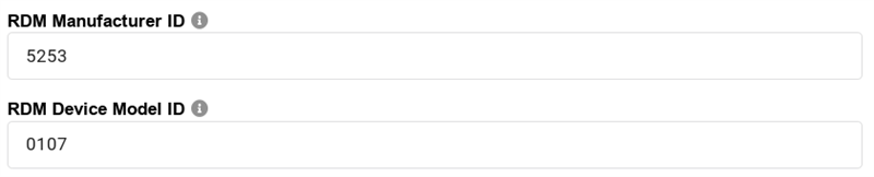

  3. Enter the RDM Manufacturer ID (unique manufacturer ESTA ID). It can be found here: https://tsp.esta.org/tsp/working_groups/CP/mfctrIDs.php.
  4. Enter the RDM Device Model ID (unique ID of the device). The Device Model must be retrieved from manufacturer documentation. It could also be available in the OpenLighting database, see this example: http://rdm.openlighting.org/model/display?manufacturer=21075&model=226 .
    For both properties, the hexadecimal representation is used.
RDM Manufacturer and Fixture IDs RDM Manufacturer and Fixture IDs

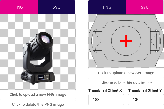

Images
It is possible to attach a product image and a vector image to the fixture type.
To add a product image, go to the PNG tab and select Click to upload a new PNG image. To add a vector image, go to the SVG tab and select Click to upload new SVG image.
Product image and vector image examples Product image and vector image examples
Use a PNG file with transparent background for best results. Read more about the requirements for product and vector images in the GDTF Spec (section “Fixture Type Node Attributes”).
To delete a product or vector image, select Click to delete this PNG/SVG image.
