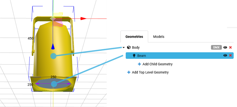

Example 1: PAR can
One of the easiest luminaires in terms of geometries is a PAR can:
It consists of two geometries:
  • The “Body”, which represents the housing of the PAR can. It has no special functions and is therefore a Normal Geometry type. Also, it is the part where you will attach a clamp to mount the fixture somewhere, so it is the Top Level Geometry.
  • The “Beam”, which represents the front lens of the light source. It appears bright if you look at the fixture and it emits the beam, so it is a Beam geometry type. It is physically attached to the body, therefore it is a Child Geometry of the body. You can tell that by the indentation in the list.
If you move around the Body geometry, you will see that the Beam moves along - this is how the top-down principle in the tree structure works. You will make use of this concept in many other places when creating a GDTF fixture.

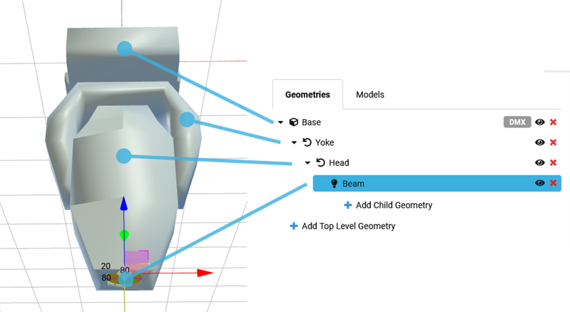

This simple moving head, on the other hand, consists of four geometries:
  • The “Base” (Normal Geometry type), which is the Top Level Geometry
  • The “Yoke”, which can rotate around the Pan axis and is therefore an Axis geometry type. It is physically connected to the Base and therefore a Child Geometry of the Base.
  • The “Head”, which can rotate around the Tilt axis and is therefore an Axis geometry type as well. It is phyiscally connected to the Yoke and therefore a Child Geometry of the Yoke.
  • The “Beam”, which represents again the front lens (not the light source itself!) and is therefore a Beam geometry type. It is physically connected to the Head and therefore a Child Geometry of the Head.

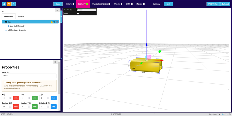

In a new GDTF file, the Geometry page will look like this:
Empty Geometry page Empty Geometry page
Empty Geometry page

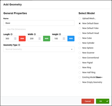

  1. Click on Add Top Level Geometry. The Add Geometry pop-up opens.
Add Geometry pop-up Add Geometry pop-up
Add Geometry pop-up

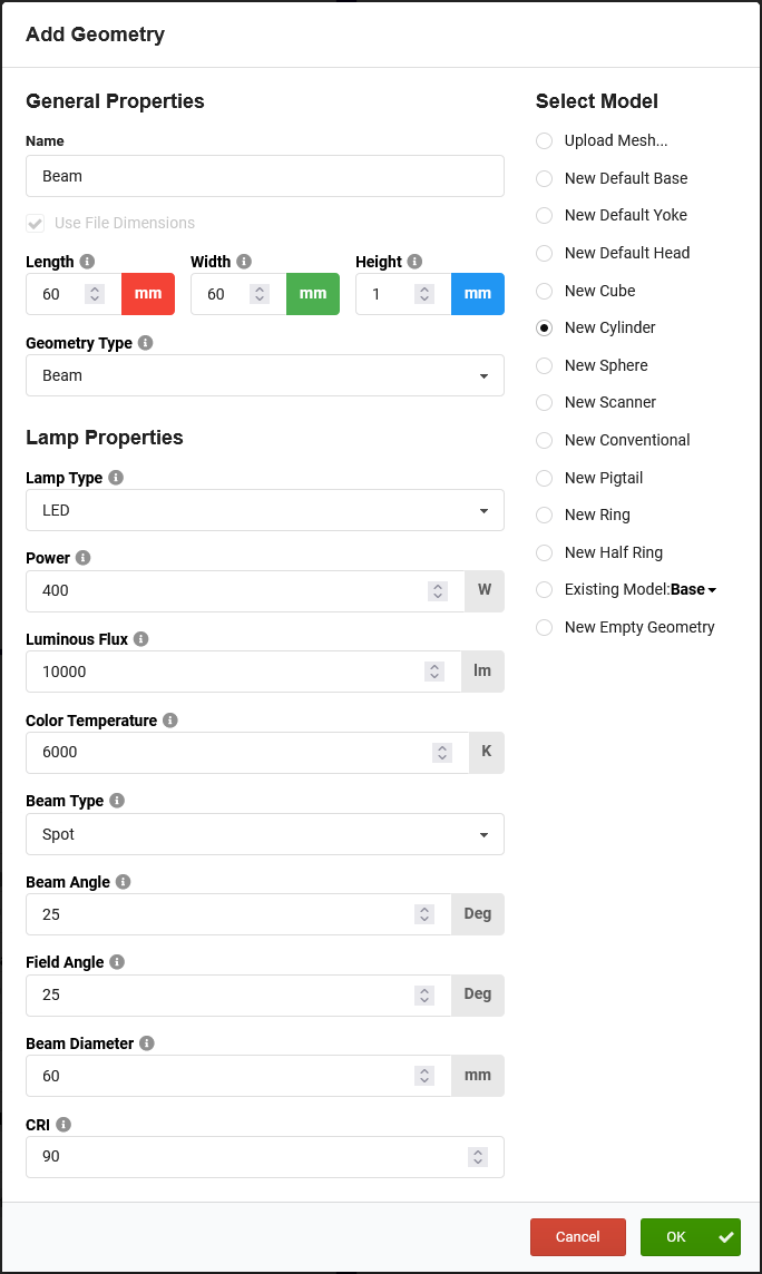

  1. Fill in the Name, Length, Width, Height, Geometry Type and Select Model as in the screenshot above. Then click on OK. The Geometry page will now look like this:

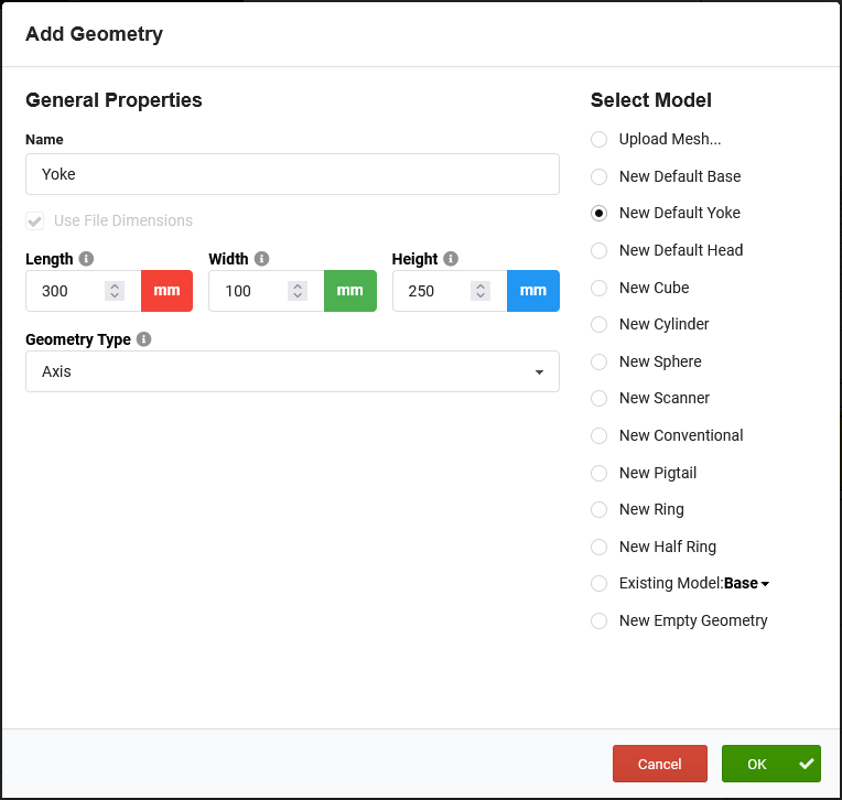

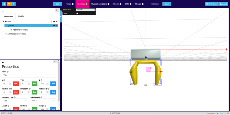

  1. With the Base geometry selected in the list, click on Add Child Geometry. The Add Geometry pop-up opens again.
  1. Fill in the properties as in the screenshot above. Then click on OK. Back on the Geometries page, use the blue arrow handle to adjust the position of the Yoke on the Z axis.
Geometry page with Base and Yoke Geometry page with Base and Yoke

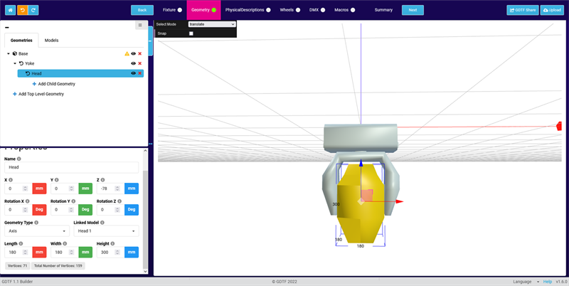

  1. Fill in the properties as in the screenshot above. Then click on OK. Back on the Geometries page, use the blue arrow handle to adjust the position of the Head on the Z axis.
  1. With the Head geometry selected in the list, click on Add Child Geometry. The Add Geometry pop-up opens again.
Add Geometry pop-up

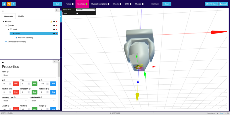

  1. Fill in the properties as in the screenshot above. Then click on OK. Back on the Geometries page, use the blue arrow handle to adjust the position of the Beam on the Z axis.
Learn more about the different Lamp Properties in the GDTF Spec.
Important: The Beam geometry must be positioned outside of the head. Otherwise there will be no light output in the visualisation!
Geometry page with Base, Yoke, Head and Beam Geometry page with Base, Yoke, Head and Beam
