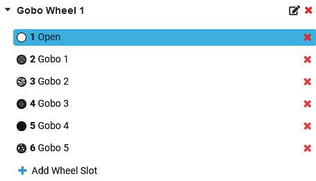

We want to describe a Gobo wheel which has indexing, rotation and shake functions and is controlled by two channels. Depending on the state of the first channel which selects the Gobos, the second channel controls either the indexing angle or the rotation speed of the current Gobo.
The Gobo wheel looks like this:
If you would like to know how to create wheels, have a look at the How to handle wheels chapter.

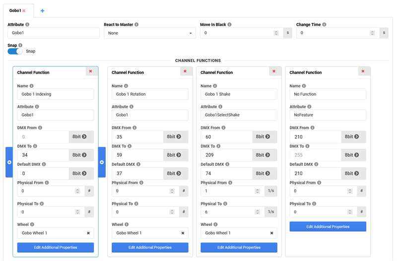

The DMX channel which controls the selection of Gobos looks like this:

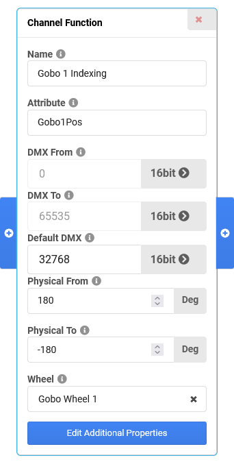

  1. The first Channel Function is the Indexing function, which uses the Gobo1Pos attribute. It is the same as for the logical channel and therefore automatically set for the Channel Function. With this channel function, you can set a fixed rotation angle between 180° and -180° for the current Gobo. The properties of the Channel Function are the following:

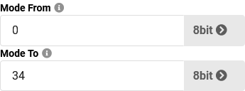

  1. For Mode Master, select the channel on which our channel depends, in this case “Head_Gobo1”.
  1. Finally, define in which range of DMX values for the master channel our channel function should be active. Confirm by clicking OK.

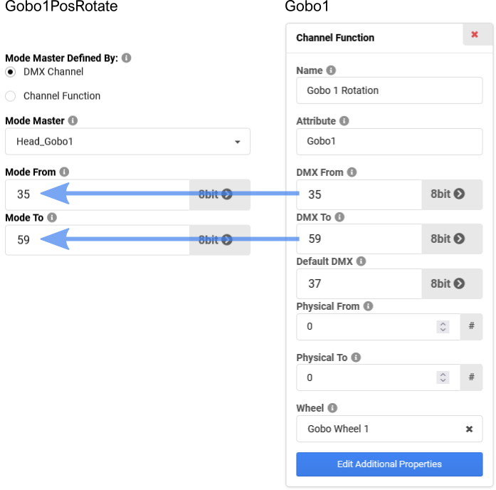

  1. Click on Add Mode Master Container. A second container will be created with a channel function. Please change the properties of the channel function to the following (using your own DMX and Physical values if needed):
  1. Repeating the steps of the previous paragraph, set the mode dependencies to the following values. You can see that these values match the corresponding channel function of the Gobo1 channel:

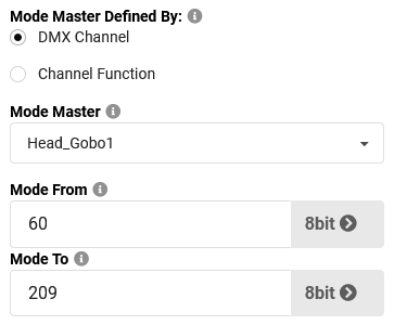

  5. In the Edit Additional Properties of the channel function, set the mode dependencies the following:
