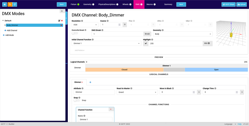

There is already a Dimmer channel which looks like this:

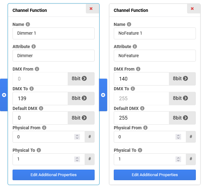

  2. As the Dimmer is only controlled in a range from 0 to 139, we need to add a NoFeature Channel Function here as well, which covers the range from 140 to 255. Click on the + icon right of the existing Channel Function and select again “NoFeature” as attribute in the pop-up.
  3. Set the DMX From value of the NoFeature Channel Function to 140. The DMX To value of the Dimmer Channel Function will be automatically adjusted to 139.

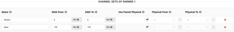

  4. You might get an error message because the “Open” Channel Set of the Dimmer Channel Function has a value of 255, which is not within the range of the Channel Function. You can adjust the DMX From and DMX To values of the “Open” Channel Set to 139.
  1. Now both Channel Functions should look like this:
